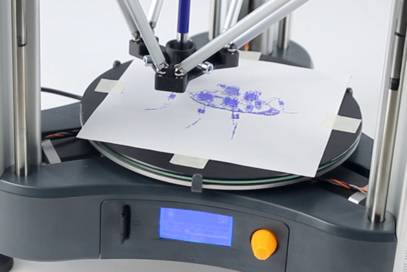

Switcheroo the printhead of your Vertex Delta 3D printer into a pen or pencil holder and let it draw the most amazing drawings, calligraphy or ‘hand’-lettering. And since it’s Valentine’s day, we made our Vertex Delta draw Boldports’ The Lady solder kit in a cool and artistic way because we just love Boldports’ designs!

Step 10: Put a pen or pencil in the holder as shown in the picture below and hold it in place by tightening the bolts until you can no longer move the pen in any direction. Make sure that the pen or pencil sticks out of the bottom for exactly 19mm and that the pen or pencil is more or less centered. Now carefully snap the assembly in place on your Delta. As you might have guessed, the orientation does not matter.

Now put the SD-card in your Delta and start the 2D print! It will ask you to place the paper on the bed. We held it in place with soft paint tape. Good luck!
