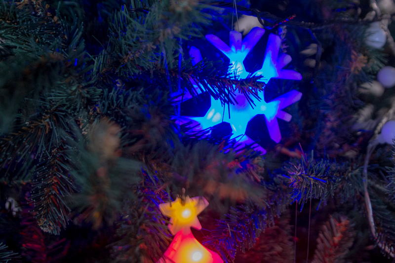

Winter Solstice is upon us! Celebrate in DIY style and make these electronic ornaments to give your holiday decorations more spunk.
They are easy enough to make, and you don’t need a lot of material. The ornament itself is 3D printed and the interior is filled with common, and easy freestyled electronics. Let’s get to it!
