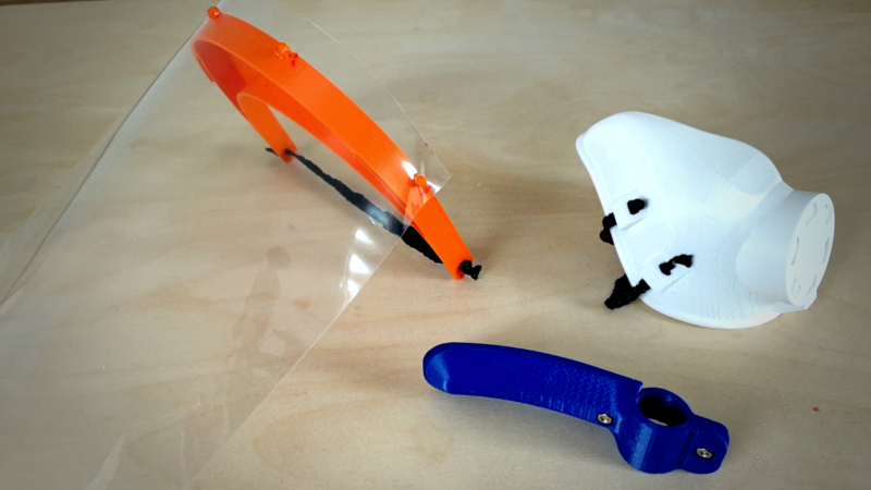

1. Face Mask
We found this face mask design on copper3d.com. Copper3d is an open-source organization that develops antibacterial 3D printing material. They want to hack this pandemic by designing and sharing this model. Their page also includes a lot of useful information and the use and safety of this face mask. Find the .stl download here.
Our experience:
- filament: we used PP filament because it is a bit flexible so it can adapt to the form of your head.
- Design: the mask has a very nice and unique design. At first, we thought it would be too difficult to 3D print on the Vertex Delta, but the Delta proved us wrong. No brim or support was needed.
- Filter: we used a makeup pad as a filter because it fits perfectly, and most people have something similar. There is more info about the use of different types of filters on the Copper 3D page. Be sure to read it!
- Result: the design fits nicely and is easy to make. However, like any safety equipment, it’s not particularly comfortable to wear.
2. Hands-free door opener
Stop spreading germs by opening your doors with this hands-free door handle. We particularly like these designs from materialise because they are very easy to 3D print and assemble. They posted multiple designs that fit different types of door handles. Once printed and installed, they enable you to open a door by using your elbow without any clumsiness. It’s ideal for public venues! Find all designs here.
Our experience:
- Filament: TPU
- Design: lots of different designs for different types of door-handles. No support is needed on the Vertex Delta.
- Extras: you will need 2 M4 nuts and bolts for the installation.
- Result: little effort, and a great result! But don’t forget to wash your elbows at the end of the day ;)!
3. Face shield
Another great design is this DIY face shield by bennoitlechasseur and based on the Prusa RC2 design that we found on cults3d.com.
Our experience:
- Filament: PLA
- Design: easy to 3D print, but brim was needed on the Delta.
- Extras: we used a Mika sheet as a shield.
- Result: the face shield stays in place nicely, and is not that uncomfortable. This is something we could definitely wear while grocery shopping.
